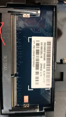

Hi there,
I have HP Pro Book 430 G2 laptop with default hardware which is 4 GB 1600 MHz DDR3L RAM option.
I want to put 2 pieces 8 GB 1600 MHz DDR3 RAM instead of DDR3L RAM.
Do you think that does it damage to the other hardware or laptop to use DDR3 RAM usage instead of DDR3L RAM usage?
Thanks for quick support.
I NEED VERY URGENT FEEDBACK PLEASE!

Actually I put DDR3 RAMs into my laptop and now it's working. But I couldn't be sure that there will be damage on long term usage. I guess laptop couldn't be turned on after I put the RAMs into it, but it's turned on somehow.

As you can see from the RAM slot of laptop, slot is saying (Not RAM) 1.5V. So maybe chipset could work with DDR3 but 4210U processor could have an issue. Or I am just assumping 🙂
I think all of the slots are labeled that way, but they are supposed to use 1.35V memory.
