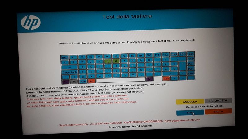

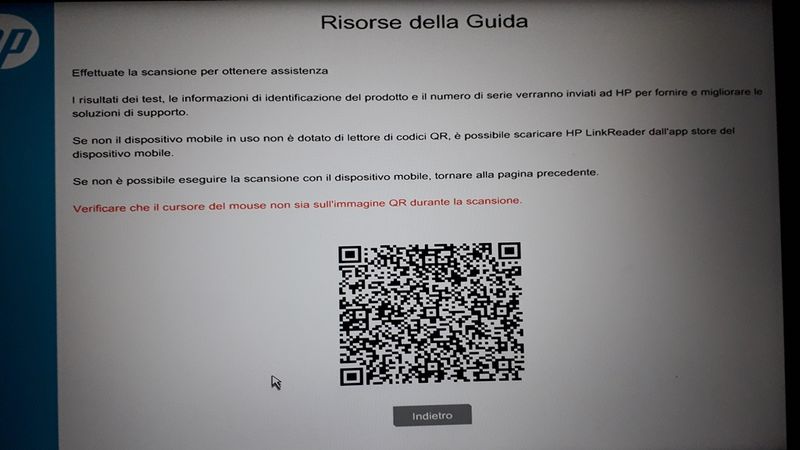

Hi, I've run the tests several times. I managed to color the number keys last. At the end of the test. At the first steps they were colorless. As well as the arrow keys, the RIGHT one in particular. I enclose the screenshots. I'm waiting. Thank you20181206_072133_.jpg20181206_073431_.jpg20181206_072153_.jpg

Thanks for keeping us posted. I see that the issue persists even after updating the BIOS . Moreover I see that the Keyboard test came up with a Failure ID.
