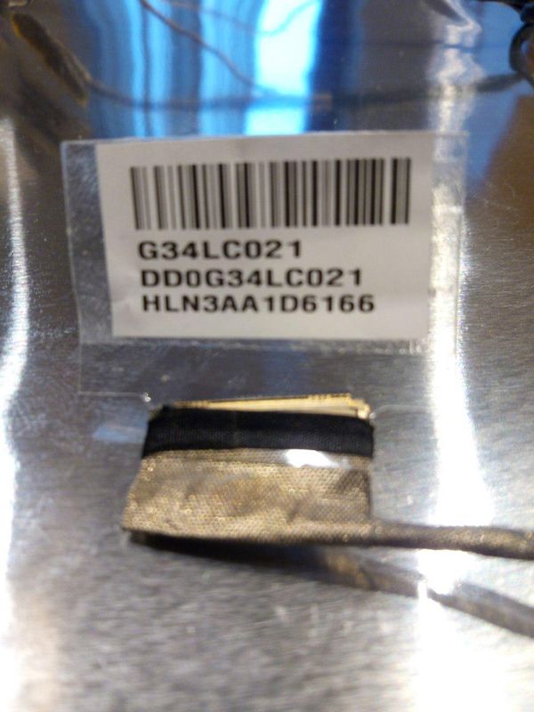

my problem is simple: I need to change the lcd cable, in particular the part n. G34LC021 / DD0G34LC021 / HLN3AA1D6166.
I already tried to buy some cables on ebay but no one worked. Where can I find a cable with all 3 correct numbers?
I can't find even in the official HP spare parts store.
Someone can help me please?
Thanks in advance.
Below the image of the part

You need this part:
Display cable
856346-001
HP Parts Store in Italy is out of stock:
Available from a UK seller through eBay Germany:
Post back with any more questions or please accept as solution if its the info you needed.
Thanks for the reply Huffer.
The part from UK seller through eBay Germany is not the right one unfortunately.
The code is 856346-001 / DD0G34LC011 but the right one is DD0G34LC021.
You are trying to look for the part using numbers that do not actually define the part. Those are some kind of stock or serial numbers. The only number you need is the HP Part number and this is the right one. You will likely never find one that has the same exact numbers printed on it.
Mmh actually I bought a part with the correct number 856346-001 but with DD0G34LC102.
It didn't work, so I doubt this.. Anyway if you are confident to your suggestion I can try to buy the part by the vendor on ebay Germany.
I am confident that the HP Part is right. Without having my hands on the computer I cannot confirm the diagnosis of bad display cable. Did you try an external monitor? Are the ones you bought before apparently plugging in correctly? Do you get anything on the screen?
