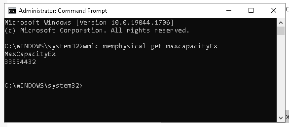

You can get a max memory confirmation by doing this...
1. In the search box, search for cmd and click Run as administrator.
This will open the command prompt.
2. Once command prompt is opened, type wmic memphysical get maxcapacityEx and hit enter.
There, it will show the maximum RAM capacity your PC's motherboard can support.
The capacity is shown as Kilobytes, so you have to convert it to Gigabytes by dividing the number provided in the report by 1,048,576.

Thanks Paul, you saved me 🙂
Yes, from the command line I could confirm that my system supports 32GB RAM even though the manual says 16GB max.
