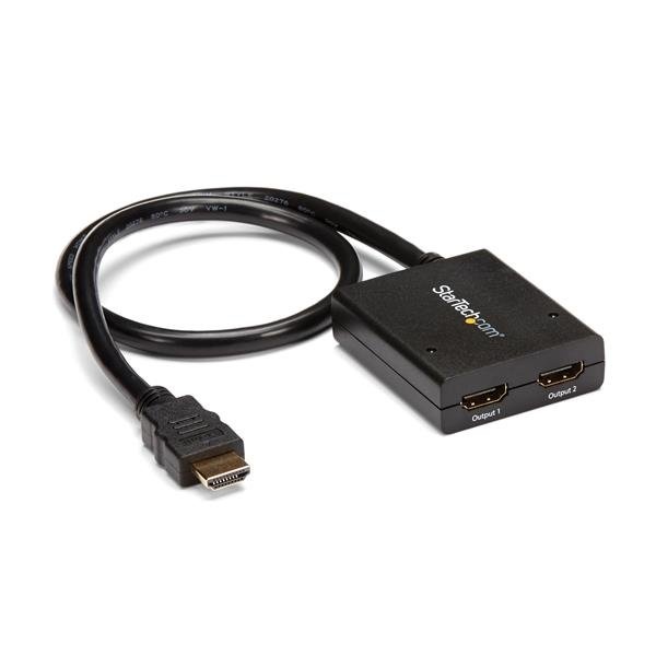

Well my main goal here is to hook up my two monitors that I use with my Dell laptop.
What would be a good fix for this?
@Hollywood12 .
You will need an HDMI video splitter
