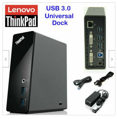

@CPU-Geek
Yes, you still connect USB-C to a dock to connect to other device. Finding a right dock is not an easy task but you can find thaousands of USB-A docks with can do the job.
I bought a cheap dock on eBay for A$70.
HP has a similar dock
           https://support.hp.com/au-en/document/c05357751
