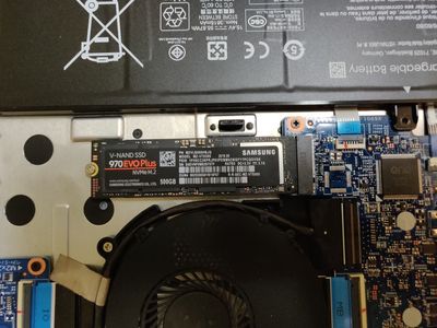

red boxred box
Thank you so much. I installed it successfully.
Good job
