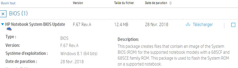

I tried to update the BIOS, as it seems old ("Hewlett-Packard 68SCF Ver. F.60, 12/03/2015" ; SMBIOS Version - "2.6") and I read online it could solve my problem.
New issue: the BIOS update downloadables are not available on HP website for this OS and this laptop: 🙃
Nevermind, I have downloaded the latest version of BIOS update for Windows 8.1:
But when I went through the BIOS update process, this is the error screen I got
Translation: "The computer is not plugged into the external power supply. Plug in the external power supply and select Enter and continue."
So BIOS update seems impossible due to my battery issue, whereas I was trying to solve my batterie issue with BIOS update.
