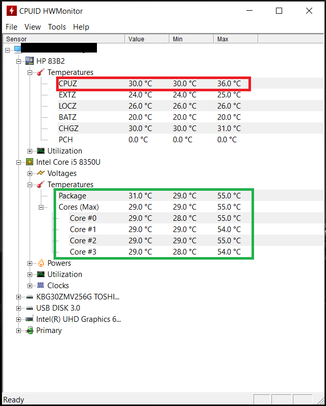

i have an Elitebook 850 G5  and pretty much the same problem. I bought my Laptop in very good condition on "refurbed.de", its pretty much like new. When i received the Laptop i have used it like it was, with the pre installed Win 10 Pro and a BIOS-Firmware from 2019.
Everything was fine for around a week, the problem has started when i decided to update the BIOS-Firmware to the most recent version. It worked fine for 1 Day after the BIOS Update, then when i turned on my Laptop the fan started to constantly spinning, but there wasn't any workload at all. I did nothing, just turning the Laptop on and not using the Browser or anything else, no update in the background etc. I have opened up the task manager and everything just looked fine.
I  decided to download the little tool "HWmonitor" and i noticed something strange. The Sensor called "CPUZ" was at 85°C all the time, there wasn't any change, normally the temps should go up or down, but not be constantly at the same temp. I thought about it and decided to install a different BIOS Version (a very old one from 2021). And what can i say, so far my problem seems to be solved.
So in my eyes it isn't a Hardware issue, it's a faulty BIOS-Firmware release. Im not new to Computers since i have a degree as " Computer Science Expert in System Integration", so i know a bit about Computers. 😉
If your problem still occurs, please try the little tool "HWmonitor" and look at the sensor "CPUZ". If it shows the same temp all the time try to downgrade your BIOS to the lowest you can get at the HP Support site.
After i downgraded the BIOS the Sensor "CPUZ" has shown a good temp, so everything was fine......

You're welcome, the support most likely would give you just standart answers.
Your numbers look good so far, but not shows completely the same sensors i guess.
Yours are most likely the green bordered numbers, while the red bordered number on my picture must be a different sensor. Im still not completely sure what the red sensor shows, but the name suggests that it must have something to do with the CPU as well.
When i had the problem the green bordered numbers were fine and changed, just the red bordered sensor seemed to stuck at 85°C all the time.
For the BIOS downgrade, i dont know how it works on Linux. On Windows i downloaded the wanted BIOS and execute the EXE file, than it shows an option to extract the needed files with the right folder structure on an USB flash device (formated in fat32).
The first option would be easier, but for this option you would need to be on the windows system where you want to downgrade the BIOS on, cause the BIOS file will be copied to the EFI Partition of your Harddrive and automatically will boot into the BIOS after a restart.
If you have a Windows PC somewhere around you use it to create the USB Flash recovery drive. If not you could try to set up a virtual Windows Machine on your Linux system with Virtualbox or something like this. Of course you would need to passthrough your usb device to the virtual machine. 😉
I think, the CPUZ values is the summary or the peak of the cores. The CPU doesn't have additional information beside the CPU temperatures per core. I posted only the values for CPU. the tool offers more under linux as well as shown below. I assume "temp1" is the same value as in your CPU-Z tool

Yes you're probably right that the cpuz value is just some kind of summary of the cpu values.
Anyway, im happy that the downgrade worked for you and the fan is quiet now. There is nothing more anoying as a noisy fan that runs all the time. Sure it sucks to be not able to use the most recent BIOS Version, but a loud fan sucks much more. Hope HP will fix the issue in one of the next BIOS Update.
Cross my fingers that your problem stays fixed.
When i had the problem with the fan and saw the stucked sensor i instantly knew there must be a problem with the BIOS, cause that was the only thing i changed. And so far it seems i was right, runs super smooth and quiet.
Those Elitebooks are great when it comes to quality, but the hardware is only as good as the software that drives it. 😁
