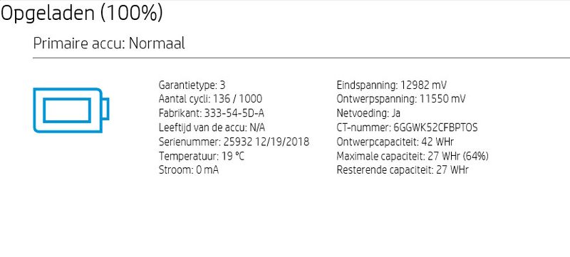

Can we see the advanced results of the battery diagnostic test?
Of course thank you. This run the capacity went down to 64 %.... never seen it this lowWhatsApp Image 2021-12-23 at 21.19.07.jpeg
Its 3 years old. It still "works" but it is weak. You will have a better experience with a new battery.
