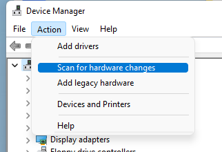

If the problem still persists, instead of unplugging and plugging back in, try using the device manager to scan for hardware changes:
If "scan for hardware changes" fixes the problem then post back here and I walk you through how to have the "scan for hardware changes" run automatically. This should not have to be done but unfortunately, I do not know of any other ways to wake up those USB devices.
