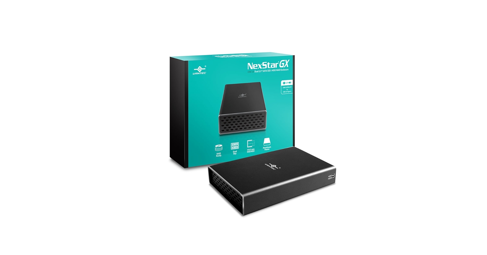

@banhien, I thought so too. I've purchased this enclosure:
Vantec NexStar TX 2.5-Inch SATA to USB 2.0 External Hard Drive Enclosure https://www.amazon.com/dp/B002JQNXZC/ref=cm_sw_r_cp_apap_rYQNT79mXhTVK
But it did not have proper connector. It seems to me that the format of the internal SATA drive connector is different and I am not sure what it is called, or how to specify exactly what the enclosure should support.
Thanks.
