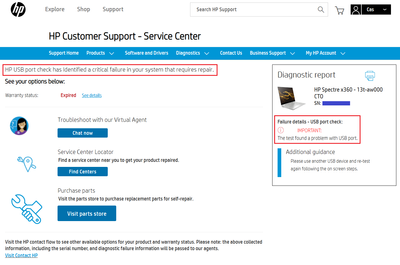

My laptop was sporadically not charging and sometimes I had to wiggle the cord.   Today, I notice it wouldn't charge at all (and of course I noticed it when the battery was almost gone. I managed to get diagnostics run on components and got this failure code on the port:
9C4FS3-9T8 BHV-MFPXHA-8D0W03
Product ID 6XL31AV
I'm kind of assuming that means that the USB port is dead???   Can this be replaced?   If so, is it feasible for me to do it myself?  And... if so,how do I know exactly what part to get??

Unfortunately, my laptop is out of warranty, so I don't seem to be able to get to HP Customer Support as your first link suggests.   I have now confirmed that I can charge the laptop through the 2nd USB port, but not the 1st, so it's definitely the port itself.
