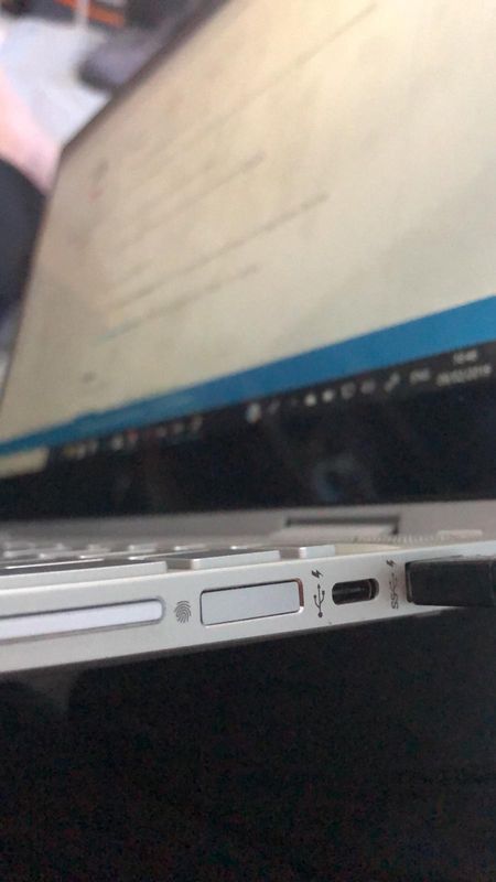

Dear @MrRobot
thanks for your reply,
if the device has no fingerprint reader,  why there is a scanner on the edge of the device?.
and also when I go to the device manager, there is a section called Biometrics.
I have attached some photos,WhatsApp Image 2019-02-09 at 4.46.12 PM.jpegWhatsApp Image 2019-02-09 at 4.46.43 PM.jpegWhatsApp Image 2019-02-09 at 4.47.17 PM.jpeg please have a look at them.
kind regards.
@KhmSY,
I'm sorry based on the specifications, I have shared you the information.
However, as now I see that there is a finger printer reader on the PC. I suggest you try performing a system reset and check if it helps.
Refer this article to know more information about performing a system reset. Click Here
Hope this works!
