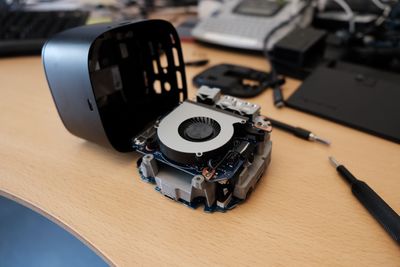

And who would have thought, no fix!! HP please help us. I've actually dismantled 2 docks, one without the fan issue and one with, i saw no difference inside. I'm tempted to just disconnect the fan and see what happens, because I'm lost.
One one the docking stations with fan
