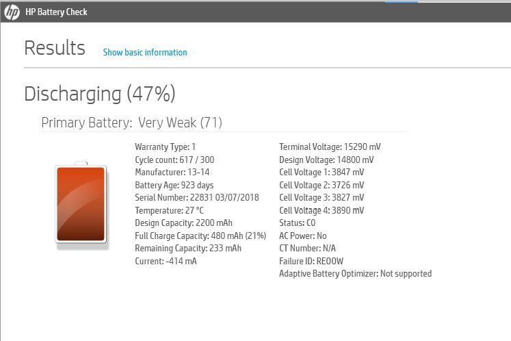

On Startup getting Primary (internal) Battery (601)
I have upgraded Bios and still receiving error on startup.
Have ran HP Hardware Diagnostics...
HP Notebook - 15-f272wm (ENERGY STAR)
Warranty status details for your product: Expired
Please help with internal battery replacement part number or link to where I can buy one.
Thank you in advance for any assistance!

You have gotten a very good long life out of that battery. Here are the replacement part numbers:
Li-ion battery
4 cell, 41-Wh, 2.8-Ah 752237-001
3 cell, 31-Wh, 2.8-Ah 776622-001
Your original battery is a 3-cell, but a 4 cell would work.
https://www.amazon.com/Replacement-776622-001-728460-001-752237-001-HSTNN-DB5M/dp/B077SW9JJW/ref=sr_...
This is a clip in and out battery so no installation instructions needed. Above is a 3rd party compatible battery but, again, will work fine and the price is right.
