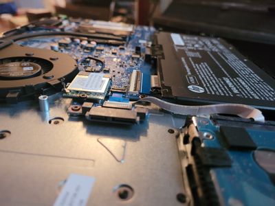

I have an HP 17z-ca000 laptop, the mother board is an 84D0 SPS:L22720-601. there is a place on the motherboard for an M.2 NVMe to go but no socket for it. Can a socket be soldered onto the spot. They must have left it off of the build because of the system I chose when I bought the Laptop

 this is what is in there now, so all I can do is remove the old HD and replace it with an ssd?  What is the other socket for?
Hi:
Your pictures seem to indicate to me that the socket is a M.2 slot.
This is what the slot part number looks like on eBay.
I have to say that I never saw one with the notch in that spot though, so I can't be 100% sure.
Notice this diagram for the notch location for a typical M.2 slot...
picture of m.2 slots - Bing images
It also looks like it is sharing a SATA connector with the hard drive, doesn't it?
The only other thing it could be would be the socket for a DVD drive.
