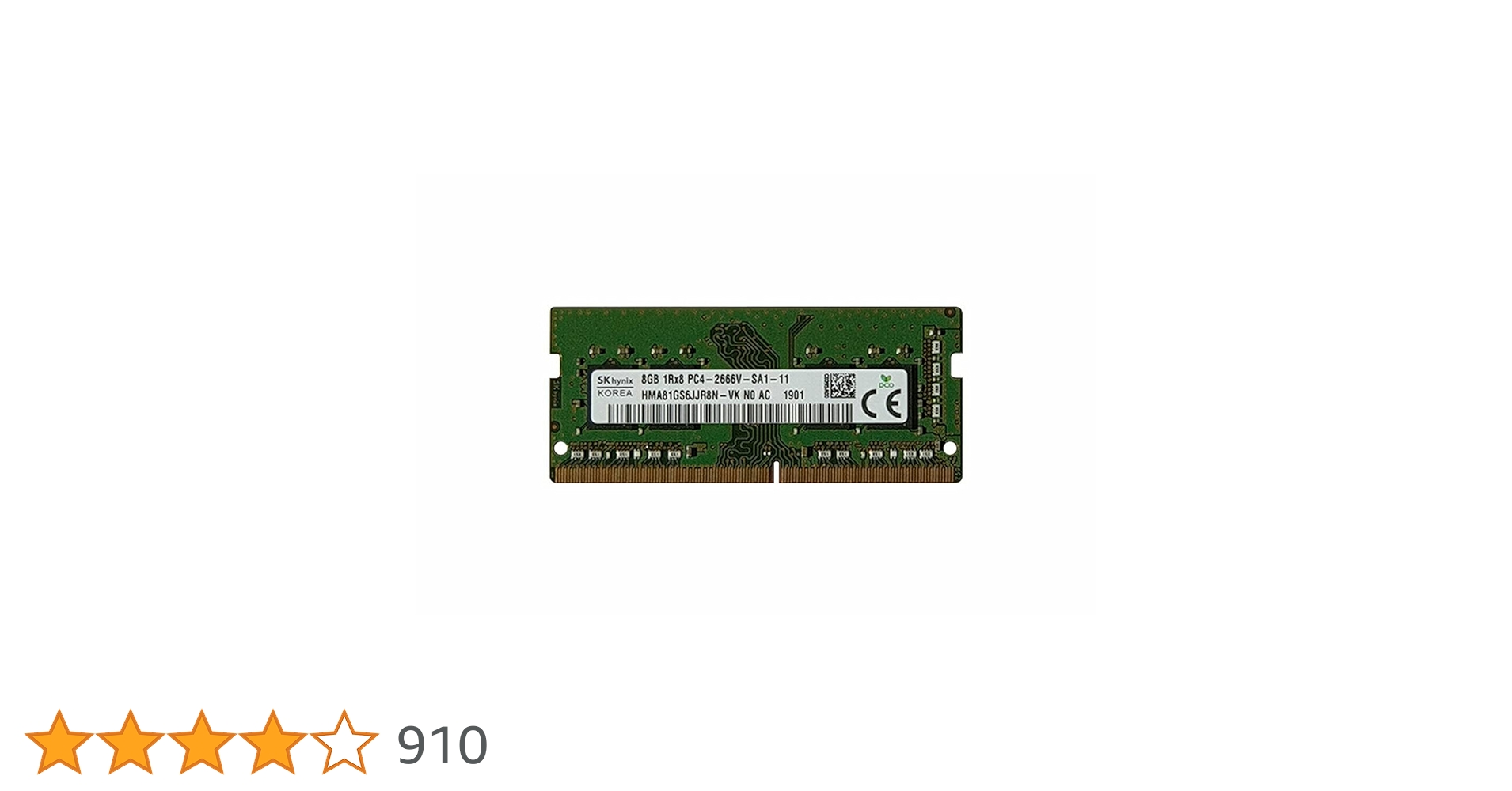

I am currently planning to add
  1. WD Blue SN570 of either 500GB or 1TB capacity.
  2. 8GB:
    Hynix 8GB PC4-21300 DDR4-2666MHz 260-Pin SODIMM 1.2V Single Rank Memory Module HMA81GS6CJR8N-VK  OR
    Kingston KVR26S19S8/8
    Valueram - DDR4-8 GB - SO-DIMM 260-Pin - 2666 MHz/PC4-21300 - CL19-1.2 V - Unbuffered - Non-ECC  OR
  3. 16GB: Sk Hynix HMA82GS6CJR8N-VK  If 8+16 is a supported memory configuration, Or go for two of this card for a 16+16 configuration
The Jobs I normally run on this machine regularly result in consumption of 10+GB of Memory(DDR+Swap).
Recommendation on right configuration is welcome.
Amazon link for the products listed above are:
16GB skHynix
8GB Kingston, 8GB Hynix
WD Blue SSD

I ordered the memory from Amazon and a wrong part was delivered. I got hma81gu6afr8n instead of HMA82GS6CJR8N-VK
the GU indicates UDIMM instead of SODIMM (GS) Is this compatible? Or will the socket only accept a SODIMM module?
Hi:
If this is the part you ordered, it should work.
HMA82GS6CJR8N-VK Hynix 16GB SoDimm PC21300 Memory (memory4less.com)
A UDIMM memory chip normally refers to the much bigger size memory chips used in desktops such as this:
Amazon.com: Crucial RAM 8GB DDR4 2666 MHz CL19 Desktop Memory CT8G4DFRA266 : Everything Else
