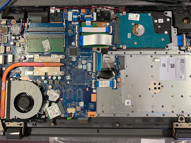

Hi, looking for some advice here.
I've bought a HP 255 G6 laptop with Freedos. It came with a 1TB HDD.
I know that M.2 SSD's are compatable with this model, but my query is whether the 255 G6 comes with an M.2 slot, allowing me to leave the pre-installed 1TB HDD in place, and install the the M.2 SSD alongside it, or will I need to remove the 1TB HDD, and use an adapter/connector board to install the M.2 SSD into the HDD bay?
The maintenance and service guide for the 255 G6 suggests that there is an M.2 slot for an SSD but I just wanted to verify this. My reason for concern is the HP 250 G6 service guide also says there is an M.2 slot for SSD, but as far as I'm aware that isn't the case.
I'm aware I could remove the back cover and check, but hoping for confirmation before i do so.
Thanks in advance.

05-20-2019 11:07 AM
Following your advice, I have removed the case but see nowhere that the M.2 SSD would install. I contacted Crucial too, and they have also said it can be installed without removing the existing HDD.
Please advise where?
