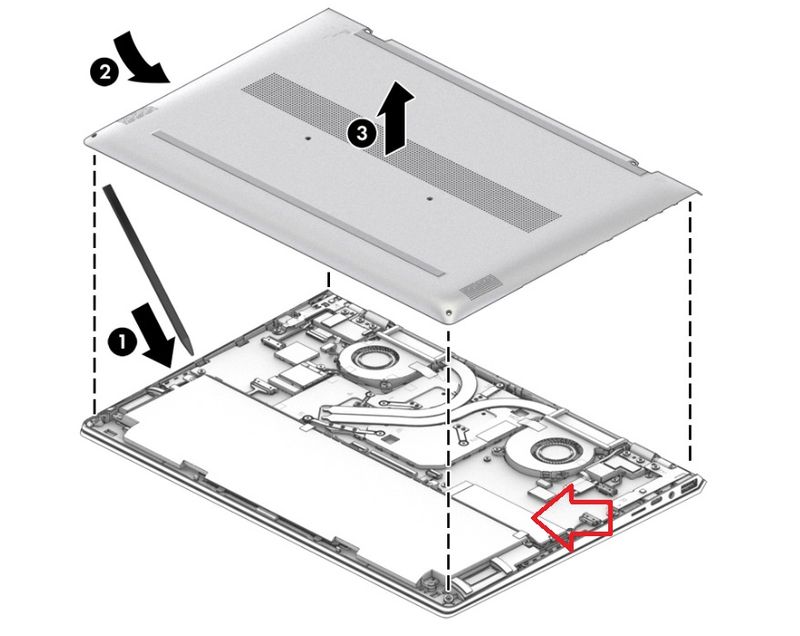

No this particular 13 inch model uses a single M.2 SSD as its storage and there is no space or port for a secondary storage device. This is what the inside looks like:
red arrow points to M.2red arrow points to M.2
All I can add is that there is a micro-SD card slot on the left side as you are looking at the screen and micro-SDs come in fairly large capacities these days.
https://www.amazon.com/SanDisk-400GB-microSDXC-Memory-Adapter/dp/B074RNRM2B/ref=sr_1_4?keywords=512+...
The speed of this would be roughly equivalent to a SATA spinning hard drive so can be used as storage up to half a TB.
