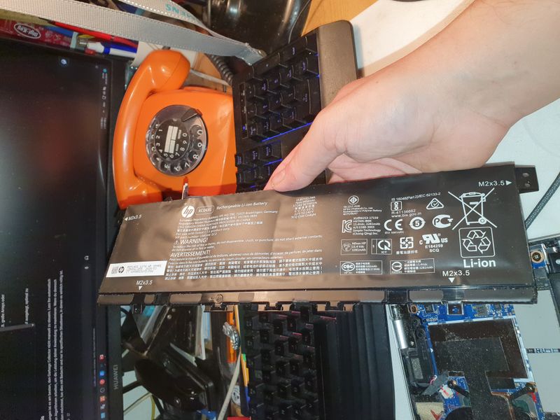

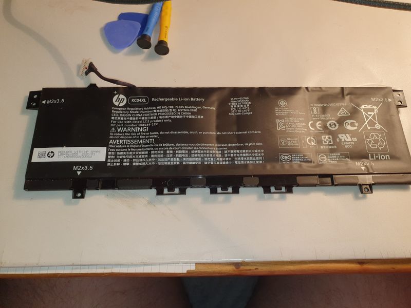

I replaced the battery, as you can see it looks really bloated!! But I did not use it much (112/1000 full cycles). This is for me a danger and I should waste it. Is there a possibility HP has an interest and would like to have the battery? Is this possible a warranty issue, because this definitely should not happen after such a short time (4years, 112 cycles of 1000, Laptop in Use!!)

Peterside 1side 1above different perspectiveabove different perspectiveside 2side 2From aboveFrom above
a battery is not only degraded by the charge cycles, but also by the heat that it is subjected to, after 4 years it is not a danger that the battery swells up, this can happen commonly in the battery of  Lithium. HP will only replace a battery if it is under warranty and this is usually a maximum of 1 year.

So as far as I understood, it might be the battery is ok. But because of certain uncertainties here, the recommendation (of you) would probably be to waste the battery  and not to repair it with a new cmos battery, right? The replacement works already perfect in my laptop, but I wanted to get sure, if I have a replacement for later use or a potentially risk or "bomb"?

these batteries when they swell, and then leave the battery deposited will damage themselves because they lose all the charge and then it is very difficult to recharge them.
