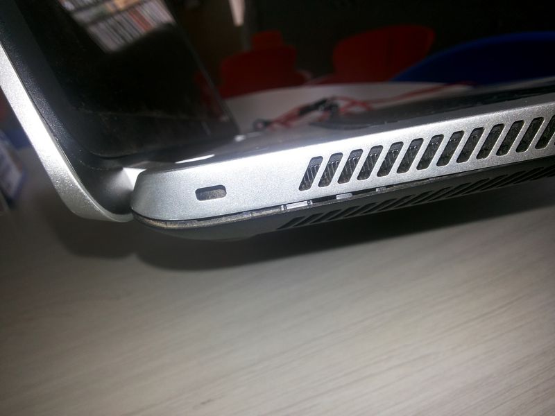

Your computer may look like this if you are having the same issue I had:

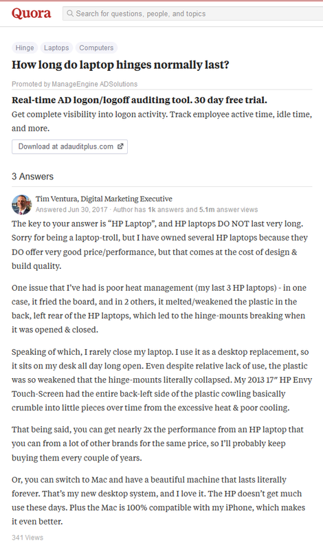

The link does not work and this diagnosis is not right. The plastic does not become brittle through heat. Its the fact that the hinges are too "tight" and require too much force to open and close. It is actually a fairly intricate engineering problem but obviously should have been figured out by the industry. The problem has become much more acute in recent years as laptop design is all about making them thin and light.
Here is some more information on the topic, there are more comments if you follow the link:
https://www.quora.com/How-long-do-laptop-hinges-normally-last

If you own an Envy be proactive so you don't end up like this fixing it yourself is quite possible and the only realistic option for people on a budget:
Here is a link for instructions about replacing a touchscreen digitizer (it covers taking the back cover off which you need to do in order to fix your own hinge problems) on an HP Envy, I do not know exactly what model it is (The pics look the same as the Envy 15-j series) if you own an Envy you should know how to take it apart and loosen the hinges / clean the fan etc. Taking apart a laptop is not bad really. I just use a decent set of small screwdrivers meant for laptops or small items (I bought the Wiha precision set from Amazon just do a quick search if you need a decent set) and I use a razor blade for a box cutter to separate / pry the case halves as it gets into the creases well and are fairly robust for prying, just be very careful with it not to take a chunk out of anything or yourself.
Here is a link for the instructions: https://www.ifixit.com/Guide/HP+Envy+TouchSmart+15+Digitizer+Replacement/62191
One thing to remember: Some person put it together, you can take it apart, you have the power to solve this hinge problem before it becomes a problem by loosening the pre-tension on the hinges. If they break you can perform the fix I did and you do not need to send it in or buy a new one until you are ready.
