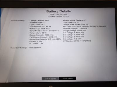

Hi @Echo_Lake,
I followed your instructions and after completing the test a few times, I have these screenshots of the test (below).
Since I am not entirely sure what they mean exactly, is the test telling me that I should replace my [internal] battery? and what's the best way forward?

@skillysantos
Thank you for posting back.
This sounds like battery failure, I would request you to reach out to our Support and our Support Engineers should be able to sort this out. HP Support can be reached by clicking on the following link: www.hp.com/contacthp/
Please feel free to contact us here anytime you need any further assistance. Please click “Accept as Solution” if you feel my post solved your issue, it will help others find the solution.
