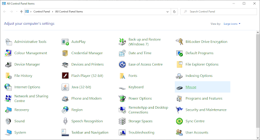

  1. Press the Windows + R keys on your keyboard at the same time to bring up the Run utility.
run: control
  1. Type in “control” without the quotation marks, then hit the OK button. This is going to launch the Control Panel in a separate window.
control panel
  1. Click on the Mouse button. If you can’t see this, make sure to change your View mode to either Small icons or Large icons.
pointers
  1. Switch to the Pointers tab in the Mouse Properties window.
  2. Use the drop-down menu under Scheme to find a different pointer. Once selected, click the Apply button to change your mouse pointer.
  3. Check if two finger scroll is working after changing your pointer.
