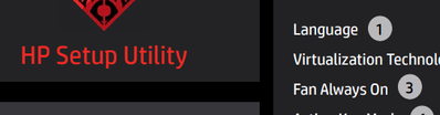

There may be a setting in the bios for "always on"
