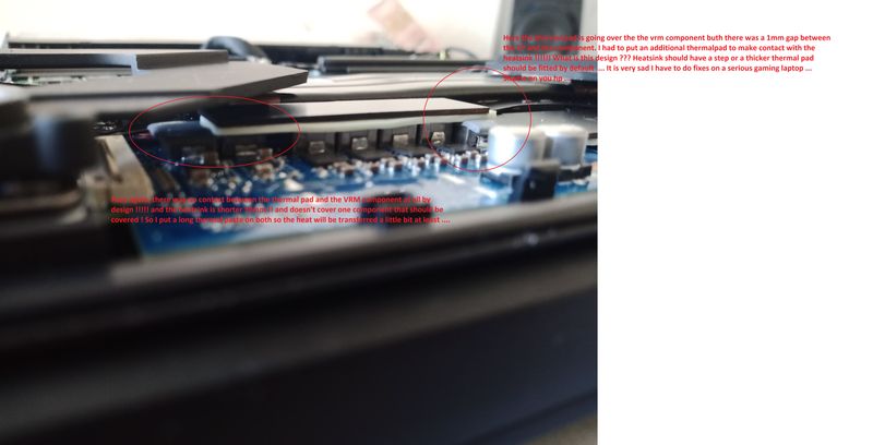

This is the 2nd picture, as you can see I highlighted an area where there is no thermal pad on the heatsink, there is 1 memory module only partly covered ! On long term run this memory module will be the first to fail due heat stress, so to avoid that I added an extra piece of gelid extreme thermal pad( a little grey bit is sticking out due even the heatsink doesn't cover fully the memory moduel ... ), to increase heat transfer. approx 1/4 - 1/3 circa 15mm2 of the memory module was not covered by thermal pad ( assembly mistake ? Or design flow ? HP should answer )
And here the 3rd player in the game ...
CPU VRM components on the motherboard were NOT IN CONTACT BY DESIGN WITH THE HEATSINK ! There was a gap between the thermal pad and component ! On the left hand side it is visible by design the heatsink is shorter at least 10mm so the heatsink doesn't even go over that component. I added gelid extreme thermal pads to make contact with the heatsink ...
Unfortunately I didn't take pictures when I was replacing the thermal paste, that would be a good learning curve as well how bad was the assembly quality, and showing how many thermal pads didn't make any contact at all with the GPU memory modules and the VRM components due the out of shape heatsink ... ( approx 1/3 of the pads didn't show any sign of contact ..)
