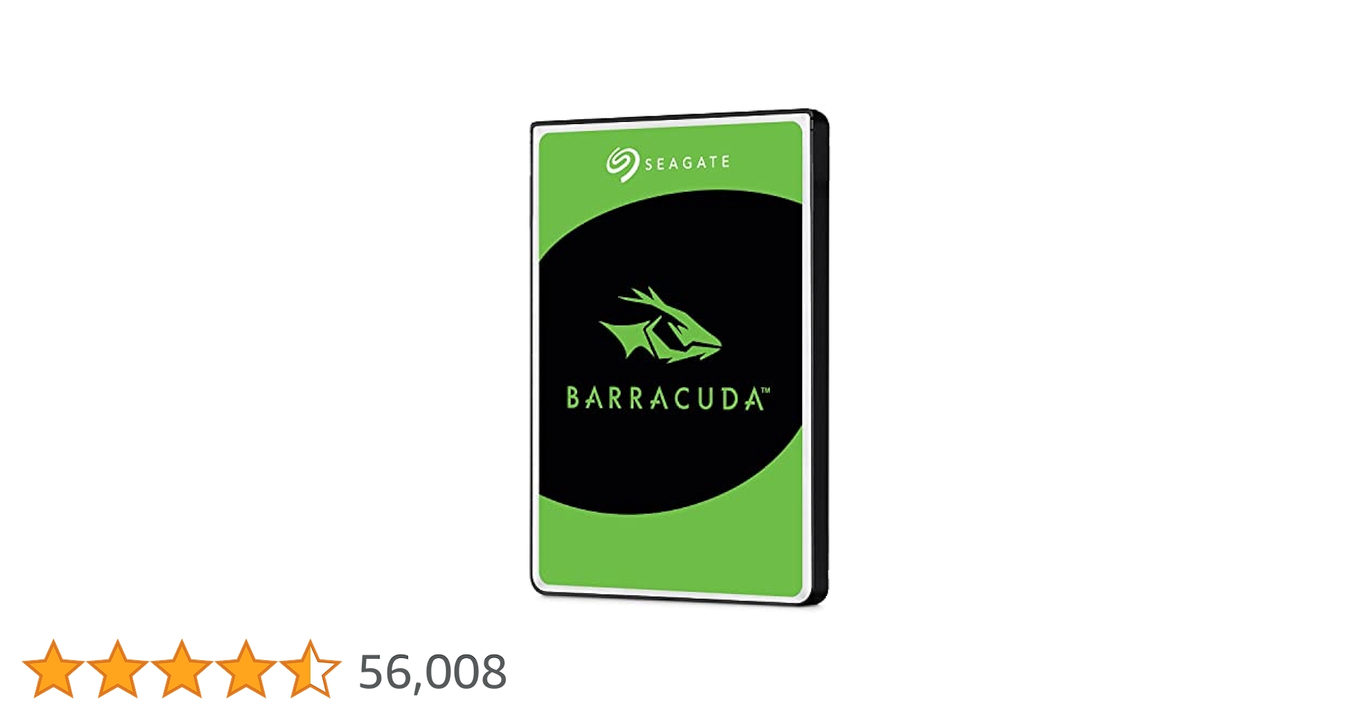

Thickness was once a problem but the market has pretty well boiled down to either 7mm or 9.5 mm HDDs and SSDs either of which will work for you. You see some thicker ones but they are for servers.  I have not purchased a mechanical hard drive for several years so I am not real clear on the price differentials. I had a bit of trouble finding a 2 TB 7200 rpm 2.5 inch drive. I think you would be fine with say a Seagate Barracuda 2.5 inch. 5400 rpm but a 128 meg cache so really performs well
https://www.amazon.co.uk/Seagate-BarraCuda-Internal-Drive-Factor/dp/B01LXRWWB6/ref=sr_1_2?crid=358Y2...

Thanks for that - "suitably informed" I'll venture forth into the online marketplaces with a bit more confidence.
