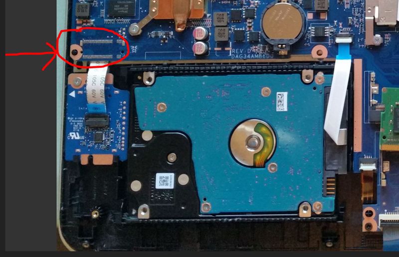

I am looking for a solution to install a M2 SSD in my HP Pavilion, I can't found the slot to connect the ssd.
I found a image that have a card to connect the m2 ssd instead off the hdd but i can't find what is this card.
HP uses the M.2-SSD (2280).
Some one can help me to solve this problem?
Hi @Ludwin08
The physical M2 slot in your PC is missing which is the case in some HP notebooks which did not come with M2 SSD. This is where the slot is missing:
Capture.JPG1
Now you could probably purchase the M2 solid state drive board and install instead of the mechanical drive, however it would be easier just to replace the mechanical drive with a 2.5" SSD such as the Samsung 860 evo.
The part for the board is 856210-001 as we can see on page 33 of service manual

Hi @Ludwin08
Capture.JPG1

Thanks very much @iomare I really appreciate your help. Your reply is the correct solution for this problem. :clap: :clap:  :clap:
