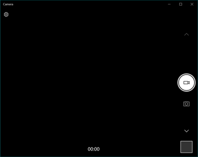

When I open the Window Camera App it only shows a black screen. Then will eventually error out.
Then I get the below error when attempting to take a video or snap a picture.
I've trying installing YouCam like some of the forums have suggested, but it did not help. I also attempted to uninstall/reinstall HP Truevision HD Camera, but now I can't get it to reinstall.
*It was greyed out in devmgmt.msc before I started any of the troubleshooting.* Now I can't get it to populate again by prompting to scan for hardware changes. I've also looked in the view tab and made sure that it wasn't there.
I've done Windows Updates, the recommended and all of the others that were available, as well all of the HP updates from the HP Support Assistant.
Does anyone have the HP Truevision HD Camera driver for this model Pavilion x360, or can they provide a download link to one that isn't filled with malware?
