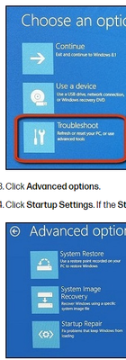

To do a startup repair you need boot into windows recovery mode. First read this article about safe mode.
Skip down to 'Enter safe mode from outside windows'. If f11 does not get you into system recovery then try turning the power on and off three or more times in a row.
When you get to advanced options select 'Startup Repair'
If the startup repair fails then try the restore point.
