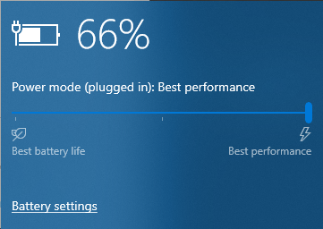

battery indicator stuck at 66%. won't go up.battery indicator stuck at 66%. won't go up.
I have an issue with the battery indicator. I don't know if this is a hardware or software issue. Even when plugged in, it's at 66%. This is still the case even if I left it overnight. It doesn't go higher like it used to.
Please help.

This is a Hardware issue with the Battery and it needs to be replaced
You can contact HP Support for Service Options
Click on this link - www.hp.com/contacthp/ and select your Country to get the Contact details for HP Support

update: i did a battery test and i got the results of a blown fuse failure ID: PUQFHD-8SDA0N-MFPUQK-C0B513
How should I resolve this?
