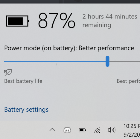

Hello, I recently got a HP Spectre x360 and I've noticed the battery does not last as advertised. At most, my battery lasted me 6 hours. I even did a fresh Windows install with no bloatware, yet my battery still does not last.The predicted time changes a lot, and it usually is very low.The predicted time changes a lot, and it usually is very low.
