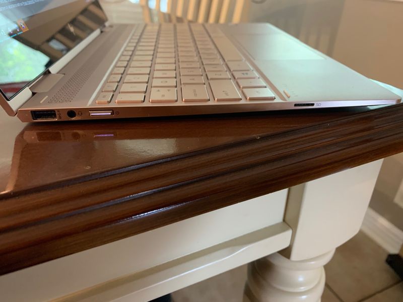

This model does not have a privacy switch. I'm adding pictures of either side to the bottom of this post.
This seems to be something in the BIOS that's completely lost reference of the machine's webcam. I'm not quite sure when it started malfunctioning, but I've seen Windows or manufacturer updates interfere with functionality in the past.

There’s nothing in device manager regarding any camera or imaging device as stated in the original post. Also, there’s no function in the BIOS to enable or disable the integrated webcam, as there should be.
