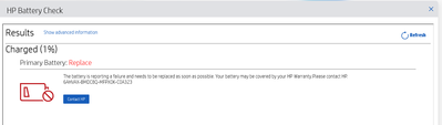

I have tried to execute the test with the charger connected and it shows no issue or problem. My battery is still in 1% but the LED indicator light is showing white color (full charge). When I try to unplug the charger while laptop is turned on, it will immediately turn off.
Also, I tried to diagnose the battery with HP Support Assistant Desktop App and shows that it has issue on the battery i think.
Of course, it has a fault ID the battery is damaged, this is the reason for not charging.
