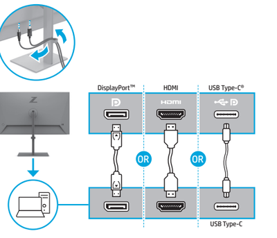

It would help if you explained how the device is setup.
What type of PC  is connected to which port on the display.
Why not follow the error message recommendation and connect a USB Type-C  cable between the PC and the display?
It will not update if you are using a displayport or HDMI connection.

Unless you connect the display to a video card that has a Thunderbolt Gen 3 or 4 USB Type-C port or to a motherboard backplane USB Type-C port that has display port capability, also Thunderbolt Gen 3/4, you will not have  any success.
