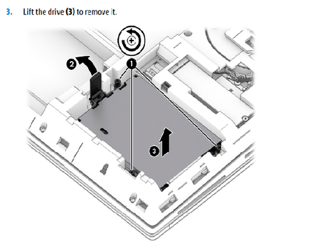

@jason999
Please use pp 44-45 of the following manual:
         https://content.etilize.com/User-Manual/1058610306.pdf
Regards,
BH
Here's the Manual:
Manual

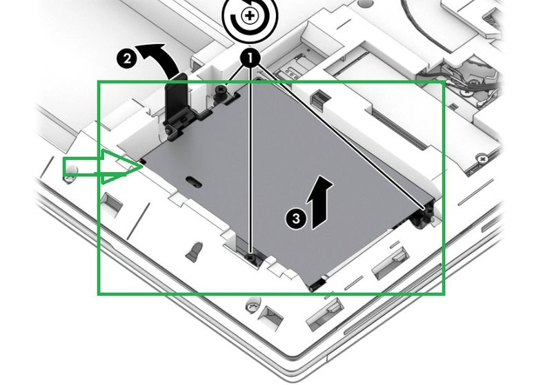

Start on p. 40 to remove rear door. In the lower right corner is the bay for the 2.5 inch standard old school hard drive:
Hard drive bayHard drive bay
However, there are also three slots for newer type M.2 "Gumstick" SSDs.
You can see one of them above the hard drive slot and then there is another one over on the opposite side above the battery.
Post back if using this information you are still unable to find the hard drive. Its very possible you only have one of the smaller gumstick type M.2 SSDs and no 2.5 inch hard drive.
