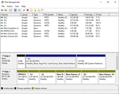

I have upgraded my laptop to include SSD which runs with PCIe interface and gives me 1.6GBPS R/W speeds on benchmark tests. My OS was earlier installed on the stock HDD and I migrated it to SSD. Even though my laptop performs much better after booting but what's disappointing is my boot time has not improved and takes 30-40 sec to fully load to my desktop. Is it that my laptop is waiting for HDD to spin up before loading? I haven't tried removing HDD and boot as I don't want to mess up with hardware. My SSD is BASIC with GPT partition and HDD is Dynamic with MBR. Could this also cause conflict?

I have PCs that mix GPT with MBR and that does no pose any booting issues.
My suggestion is that you disconnect the HDD and see if that makes a difference.  If it does, then Windows is likely indexing the HDD as part of the boot process and that is slowing down the whole boot.

Hi @WAWood Thanks for your reply.  Based on your inputs I tried the below steps but nothing helped:
1. Disabled indexing in each drive and disabled search services altogether.
2. Disabled HDD and CD ROM drive from device manager (not physically though) and ensured it is not showing in Disk Management.
3. Clean boot Windows 10 disabling all services from System Configuration Boot Menu.
However none worked and boot time is still at 40 sec. Please suggest your feedback.
