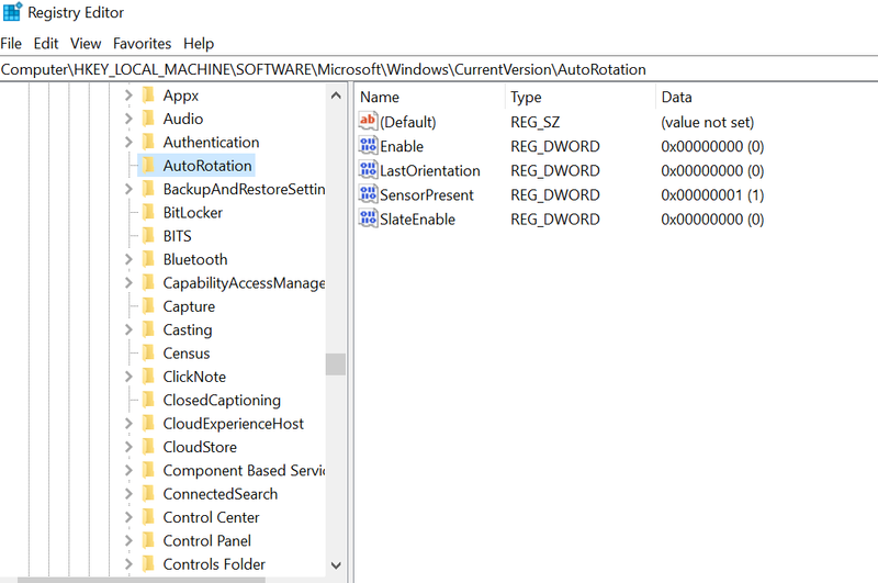

Dear Sirs,
The problem is not that Giroscope doesn't work but, that it works as inverted
Anyway, please clarify to me which record have to be changed
Here in attachment the registry screen shots of current configuration
Regards
Vincenzo
@Vinzlp
Thank you for the screenshot.
Change the value of the LastAutoRequest from (0) to (1)
Keep me posted.
ECHO_LAKE
I am an HP Employee
I changed the constant as per your sugestion and restarted the PC.
No improvement has been observed the isuue is still present
regards
Vincenzo
keyboard and mouse disabled
