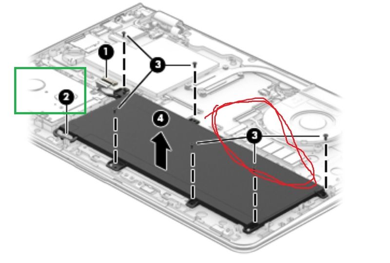

2 TB will be no problem. Here is the Manual:
Manual
Start on p. 27 for instructions and hard drive is covered on pp. 30-31. Inside see this:
hard drive in green square M.2 circled in redhard drive in green square M.2 circled in red
This drive would be fine for storage:
https://www.amazon.com/Toshiba-5400RPM-Cache-Internal-Notebook/dp/B08FBNJ8ZG/ref=sr_1_5?dchild=1&key...
Post back with any more questions and please accept as solution if this is the info you needed.
