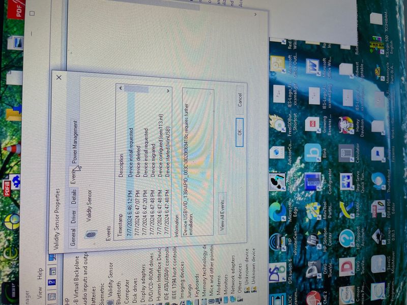

07-15-2024 06:20 AM
Hi Paul,
I deleted the two biometric devices with no properties, restarted Win10 and rescan for new devices, it then allowed me to load your driver. This is what I have see now. it says it needs further config?
Win Hello still does not recognize it, neither does HP Simplepass show setup option for it.
Thanks for your patience.
