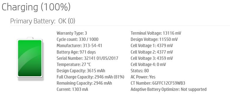

Run the HP Battery Check from the HP Support Assistant app and on the results screen there is a link to "show advanced information" or something close to that. Click on it and you get much more data about your battery. Post that and we can help you decipher. I really don't need to see that. I know from your description of how the laptop works it needs a new battery.

Apologies for the delay. I thought there must be more to that support app, ha ha. Thank you. I will try that tomorrow and come back to you. It's odd, today it was on 100% after being taken off charge 2 days ago so the battery is good at times or awful. I hope we are both right that it appears to be the battery as it has been playing nicely lately ha ha.
OK, here is the screenshot of the diagnostics with and without the power attached. As you say, it is likely it will be the battery and I'm (hesitantly) more comfortable it is not the power supply. Hopefully these will confirm it. Could you let me know what this tells me as I suspect this issue will reoccur in the future and it will be good to know. Many thanks.
