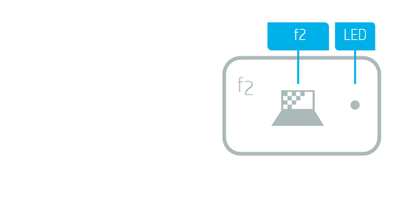

Is there a link to a site to verify by serial number that a HP laptop like the X2 EliteBook 1013 G3 has SureView installed as a Hardware feature as HP site states this should be selected upon purchase but cannot see if HP machine has the feature

Hi,
If you have this key on notebook it has sureview
If you do not, it does not.
Hope it helps,
David
Many thanks for your reply.
I do have the key and I have reinstalled the software and I have tried 3 different x2 elite and none of them work hence I was wondering is there any other way of verifying it is part of the hardware.
