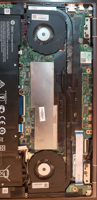

I have a Spectre x360 - 15-bl075nr with a faulty motherboard. Can someone please help me confirm if a MX150 2GB i7-8550U  motherboard will be compatible with my laptop? Below is a picture

Hi,
Yes. On page 49 of the service manual you can see the compatible boards with the part number.
http://h10032.www1.hp.com/ctg/Manual/c05357610
