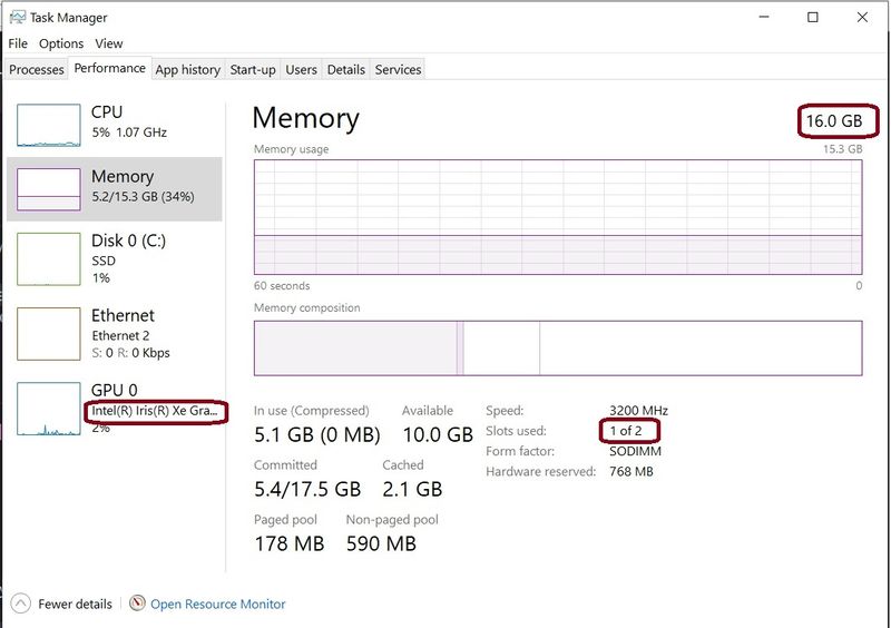

@HufferThis might be one of the few cases in which a hardware-level GPU upgrade might be possible (sort of). HP generally prefers using single RAM modules on systems, and if this system has a single 16GB RAM module -I know my Tiger Lake and Alder Lake G8 and G9s did- then the Intel graphics chip will not be performing as it should. For that reason, switching to a dual-channel memory config is the first thing one should do on Iris XE systems.

From personal experience the difference in performance is 30%+. The reason has sth to do with the design of the new Iris XE chips that can only work as Iris XE if provided with dual-channel RAM setups. You actually have to test the difference yourself to see how surprising it is. Hence the link above about the mystery.....
Hello @TzortzisG ! How can check if my laptop is using a single 16 gb RAM module or  two 8 gb modules?

There are many ways to find this out. The simplest is from Windows Task Manager. This is what you'd get on your system with a single (1) 16GB module installed.....

The laptop is using two modules, 8gb of RAM each. Now I've enabled the high performance power plan.
