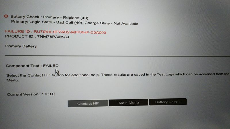

Here are my laptop details and the result of battery test done.

Yes it is the correct battery.
You can use the sr03xl or the sr04xl
take care
David
6 REPLIES 6
Hi,
Yes, it is normal for a battery to lose a large amount of capacity after 18-24 months.
Usually, I replace the batteries every two years in my notebooks
On page 45 of service manual you can see the compatible batteries
http://h10032.www1.hp.com/ctg/Manual/c06219881.pdf
You can try performing an online search with part number to find a compatible battery
Hope it helps,
David
Please click on yes for thanks
Please click on accept as solution if answered your question
in manual L08855-855 is given but in market its termed as
L08934-1B1" are they same ?
take care
David
the SR03Xl has 11.5 V and SR04Xl has 15V my laptop shows battery voltage to be 11.5 volt so can i use the SR04Xl as it has more capacity ?
the seller website tells "up to 500 recharge cycles is it less or optimum" ?
