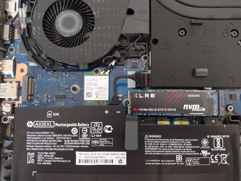

The second slot - there is only room for a small m2 drive - I have an m2 sata drive, which was the original drive which is too long to fit in the space.
I've attached a photo.
Can I still install the sata m2 drive? (its the same length as the NVME drive) How would I hold it in place?  I could use the cable from the battery to hold it down, risky maybe but the laptop doesn't get moved about much.
I believe that slot is only for WWAN (cellular modem). Look at p. 46 of the Manual. The second M.2 SSD slot is off to the right of the memory slots.
