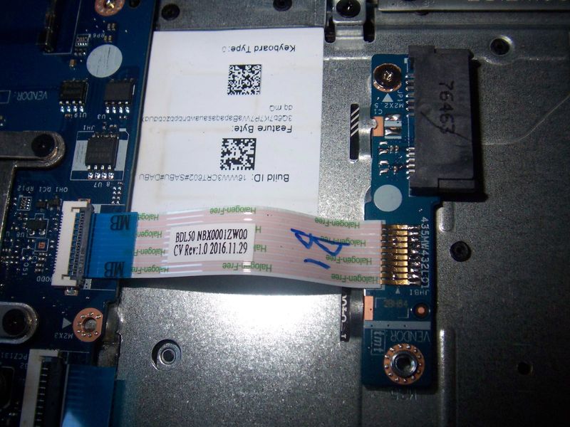

When I opened up my laptop to clean and service it I saw what looks to me like a mSATA port and I'm wondering if it'll support 240gb, if it is indeed mSATA. I've tried to find details about my motherboard with no success and have drawn a blank searching online.

Thank you, that is a very useful document and its very kind of you to reply. But I'm sure what I saw inside wasnt for three pronged cards like m.2, only two prongs like mSATA... The plot thickens.
mSATA is 30mm wide and m.2 SATA3 is 22mm wide (socket can have 2 keyed notches [B+M] for wider compatibility). Which one is yours?

Scrap my last message, you're right, it is m.2. I think nVme?... There is no screw hole to mount a retaining screw for a m.2 drive though, is this a problem or just how it is with some laptops?
And, in your opinion is this compatible as a boot drive? Assuming the lack of retaing screw mount doesn't make it impractical. 51Ase3nBTAL._SY355_.jpg  Thank you again for your help and patience with this, you're a star.

That looks like the CD/DVD connector.
Your model can have a HDD/SSD or a M.2 SSD but not both.
The HDD/SSD and M.2 SSD take up the same slot.

Yes, it looks like an 2.5" HDD/SSD attachment. See page 50-51 of the maintenance guide.
From the looks of it, you have to purchase m.2 attachment P/N:850946-001 (solid state board with circuit and cable) to work with m.2 drive. See page 56. The screw hole is probably hidden beneath the 2.5" attachment or on the solid state drive board.
I can see one listing on ebay.co.uk
Edit: ask the seller if the solid state drive board is included.
