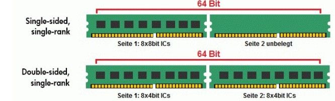

you can upload a CPU-Z image, usually many users make the mistake of confusing single rank with dual channel.
Where single rank indicates that the memory has the chips on one side only, is not related to the dual channel

the first image is the correct one, it says that it is working at double channel 2x64bit, which indicates that they go to 128 bit which is the indicator of the double channel, the other image indicates exactly what I said before are single rank memories that indicate that it has only one chip on one side.

You are not misunderstanding, you are already in dual channel, when you have 2 x64 bit indicate that the meiras instead of working at 64 bit are working at 128 bit which increases the data transfer between the memories to double (128 bit) which indicates that they are working in dual channel.
The single rank is the hardware is using memories that actually have the memory chips soldered on one side of the memory, there are double rank memories that have the chips on both sides of the memory.
