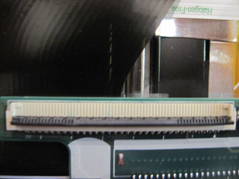

10-09-2022 07:32 AM - edited 10-09-2022 07:39 AM
Hello @cruisinfanatic
There is something wrong here. Take a magnifying glass and check all contacts in this area very carefully!
? Is this the correct socket ? It seems to me larger than the number of contacts on the keybaord ribbon cable ?
