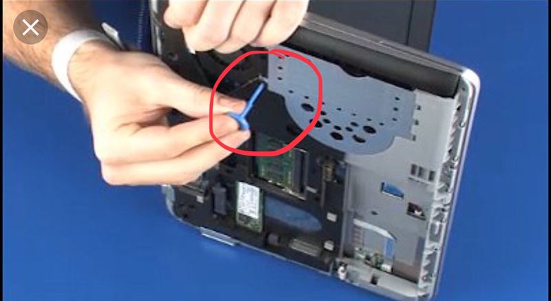

I want to replace my laptop keyboard with a backlight keyboard. So I ordered the new keyboard and have my service manual, I take all the screws out just for it to say use the keyboard release tool to loosen the keyboard??? WHAT?? Anyone have any idea where I can get this keyboard release tool? I found a pic of it online but no part number for it anywhere. Help please!
Keyboard release tool??Keyboard release tool??

Sorry but that picture does not look  like your model???
The keyboard for that model is attached to the Top Cover???
REO
@REO51ST
She said that is a picture she found of the Keyboard Release Tool mentioned in the Manual. I checked the manual and it does show using such a tool. I haven't found any place it is available.
@DigitalMom40
I would assume that any similar shaped object could be used-maybe a long wooden skewer,etc.

@DigitalMom40
A wooden skewer should do the job or as we have hundreds at work "Chop Sticks"
REO
You don't need one.  place the laptop on a flat surface, apply pressure to the keyboard, "pulling it down" to create a gap at the top then pry it off.
If you must push it off from the back a spunger "black stick" has done it in the past
